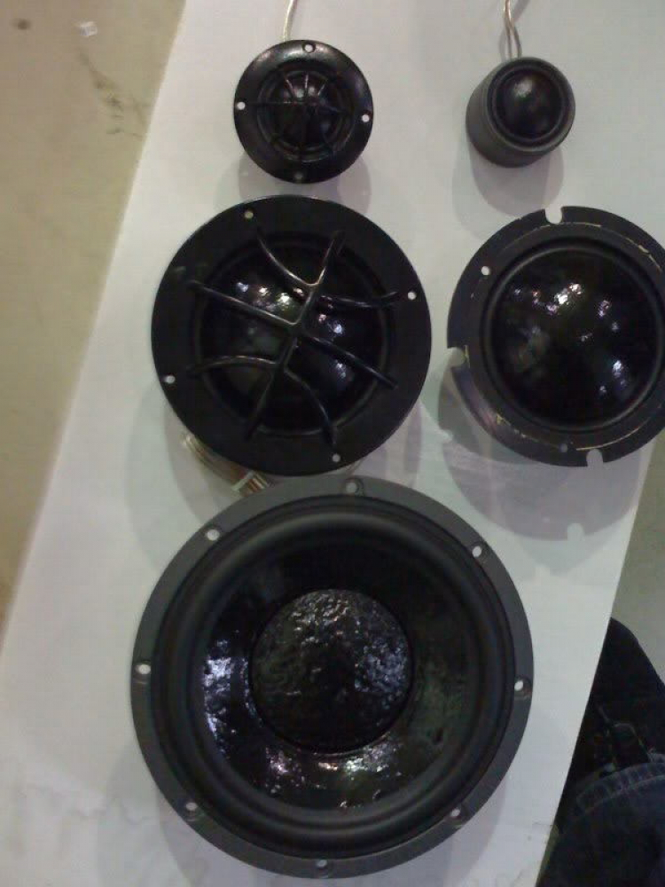

Loa trép rời DLS series NOBELIUM 1 - size 2,8cm
Camry trắng - PROJECT SOUND QUALITY
Loa midrange rời DLS series IRIDIUM 3i - size 7,5cm
Loa Midbass rời DLS series IRIDIUM 6I - size 16,5cm

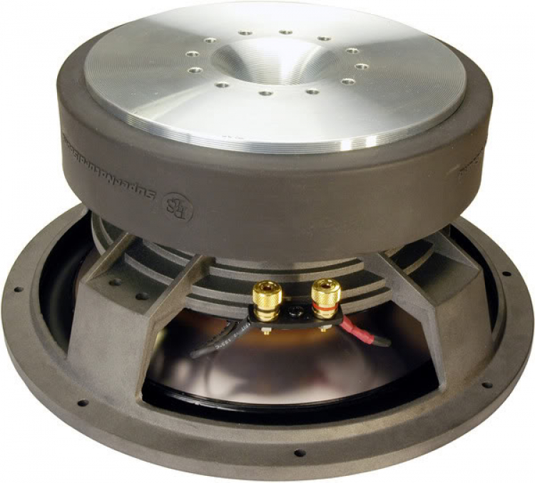

Loa subwoofer DLS series NOBELIUM 12 - size 30cm
