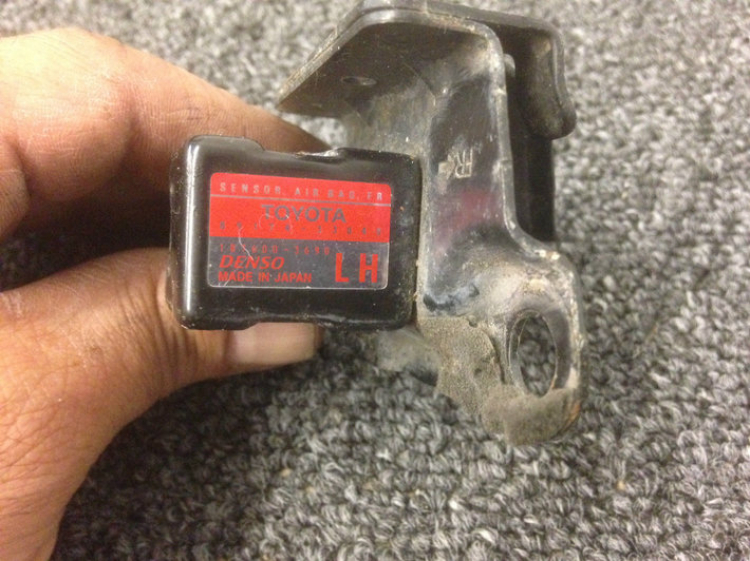

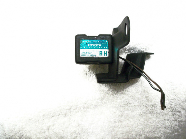

Airbag sensor nè
89174-33040 bên Left
89173-33040 bên right

Airbag sensor nè
View attachment 150827 View attachment 150828
