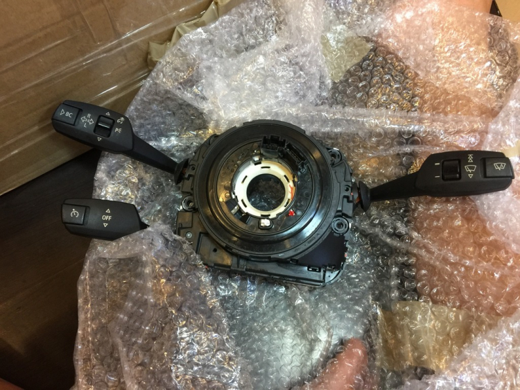

***XE E90 320I LCI Ở VN BỊ CẮT RẤT NHIỀU OPTIONS TRONG ĐÓ CÓ MỘT OPTIONS MÌNH THẤY RẤT CÓ ÍCH LÀ CRUISE CONTROL. EM TÌM HIỂU BÊN TÂY THÌ HỌ CŨNG RETROFIT ĐƯỢC MÓN NÀY. CÁCH LÀM CŨNG ĐƠN GIẢN, CHỈ CẦN LẮP BỘ NÚT RỒI CODE LÀ XONG Y CHANG DÒNG F-SERIES. THẾ LÀ EM TIẾN HÀNH MUA ĐỒ VỀ LÀM ĐỂ ĐI ĐÂU XA CHẠY CHO THƯ GIÃN.
PART CHI GỒM 2 MÓN
1. BỘ BỢ CỔ CÓ CRUISE CONTROL:

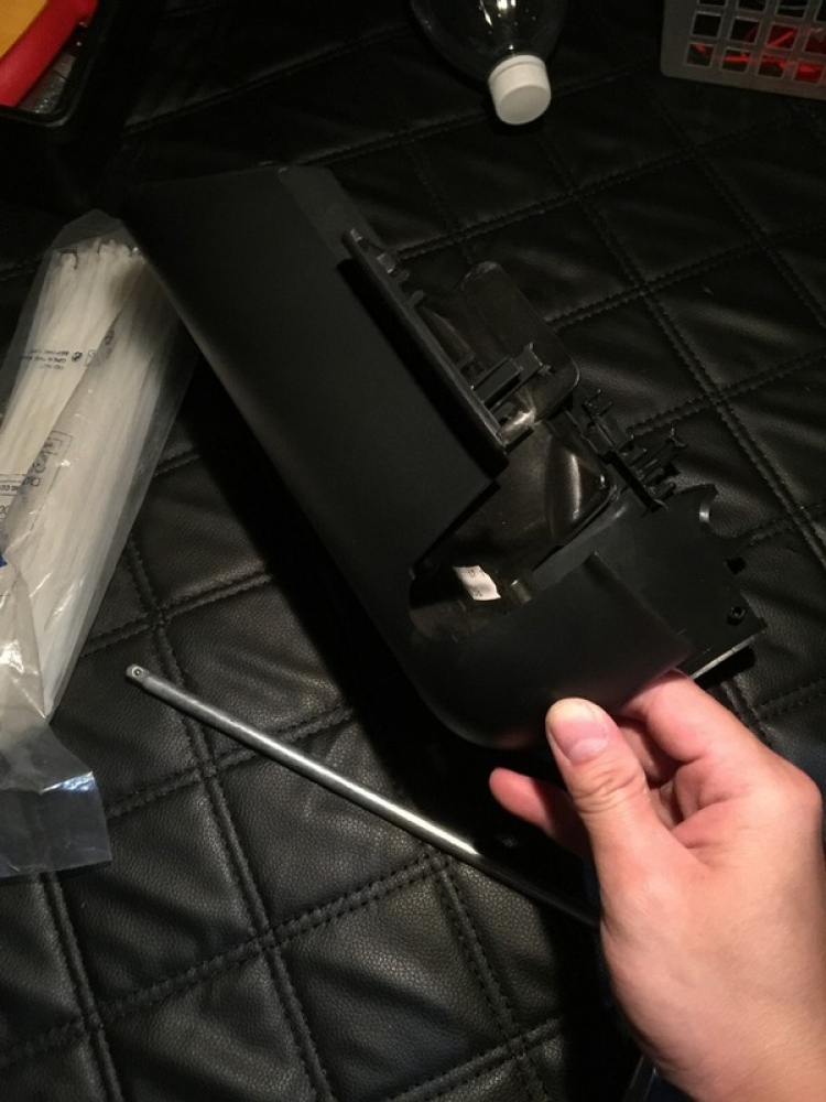

2: MIẾNG COVER COLLUMN BÊN DƯỚI: AI KO MUA THÌ KHOÉT MIẾNG ZIN CŨNG ĐƯỢC:

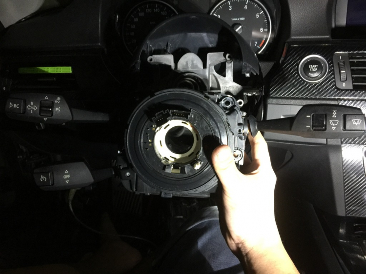

CÁCH LẮP CŨNG KHÁ ĐƠN GIẢN, ĐẦU TIÊN THÁO VÔ LĂNG RA:
THÁO COVER RA MỞ 4 CON ỐC LÀ RÚT ĐUỌC BỘ BỢ CỔ ZIN, LẮP BỘ CÓ CRUISE CONTROL VÀO
LẮP COVER COLLUMN VÀ VÔ LĂNG LẠI LÀ XONG
SAU KHI LẮP XONG PHẦN CỨNG THÌ CODING ĐÊ XE HIỂU CÓ OPTIONS CRUISE CONTROL LÀ DONE.
PART CHI GỒM 2 MÓN
PART CHI GỒM 2 MÓN
