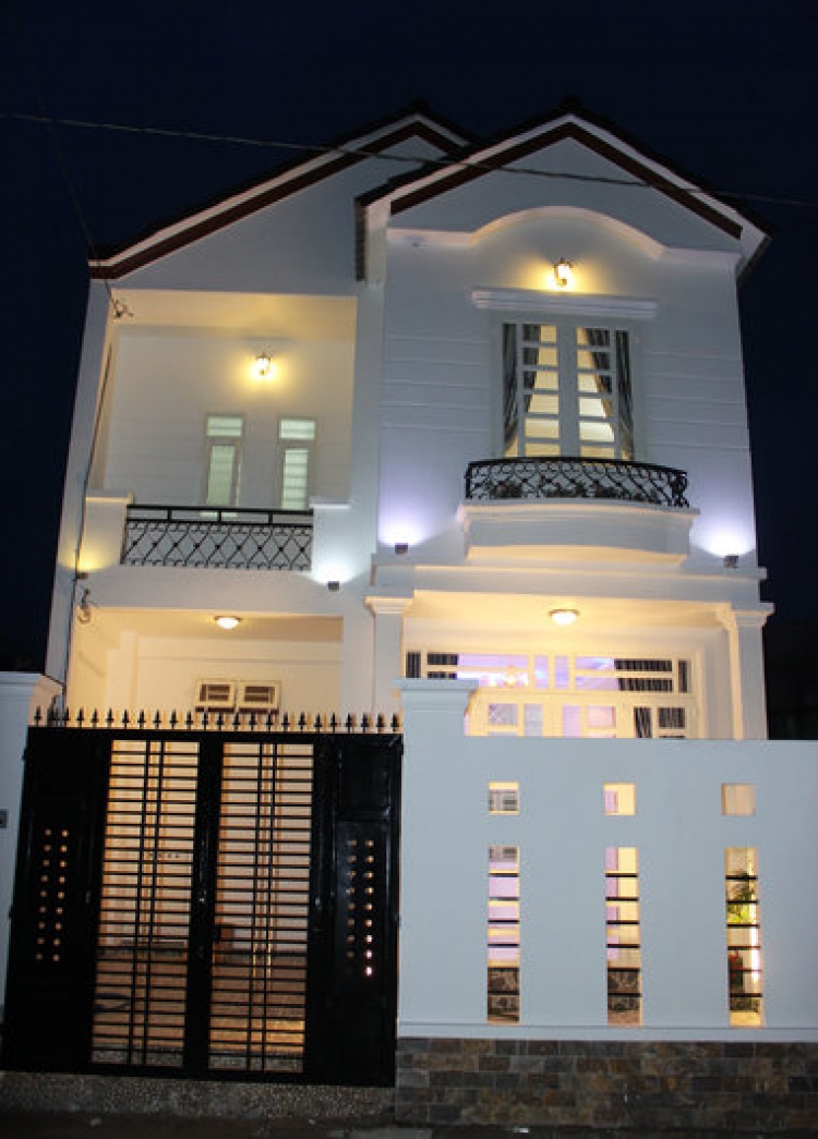

GẤU NHÀ .MỚI ĐƯA MẪU NHÀ .GẤU EM KHOÁI MẪU NÀY.
MÀ SUY ĐI NGHĨ LẠI GẤU ĐÂU CÓ Ở, GẤU ĐI NƯỚC NGOÀI Ở RÙI .MÀ CÒN RA LỆNH ,MỆT THIỆT MÍ BÁC. KHÔNG BIẾT CÓ BÁC NÀO RƠI VÀO HOÀN CẢNH CỦA EM KHÔNG,
KÍNH NHỜ CÁC CHUYÊN GIA XÂY,CẤT NHÀ HỘ EM Ạ.

HIC GẤU NHÀ SÁNG NAY ỌI RA THÊM 100 NŨA LÀ 4T5 RÙI.CHẮC ĐỦ,CÓ THẰNG EM 30 NĂM TAY NGHỀ XÂY DỰNG,NÓI CỨ CHƠI 1 LỖ 40 CÂY 5M ZỌNG XUỐNG LÀ NGON, VÀ SẮT 18 BINH KIỀN THÊM THÌ KHÔNG RĂNG ,NỨT.
CHẮC BINH LUÔN MẪU NÀY, TUẦN SAU ĐI CẤN THƠ ZÌA LÀ BẮN.
GIỜ CHỈ TÌM C/TY XÂY DỰNG CHO ĐÀNG HOÀNG VÀO LÀ CHỐT.
EM LẠI THÍCH MẪU NÀY ĐƠN GIẢN ,RẺ ,PHÙ HỢP VỚI EM HƠN
